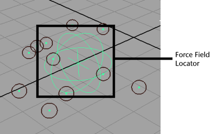

The Force Field locator appears at the center of the selected nParticle object, and the dynamicConstraint node appears in the Attribute Editor.

The location, size and rotation of the locator determines the size, shape, and volume of the Force Field constraint.
