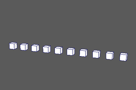

- Linear: Distributes points along a line.

Linear
- Center Distribution
- Distance X, Distance Y, Distance Z
- Controls the spacing between points in each of the three axes.

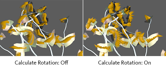

- Calculate Rotation
Paint Effects Strokes and a provided
Up Vector. This is useful for doing things like custom leaves on trees.

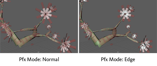

- Pfx Mode
Paint Effects Strokes chosen. Options include:
- Normal: Places points relative to each vertex on each stroke.
- Skip last point: Same as Normal, but ignores the final point that would be placed on each curve. Useful when instancing new leaves for a Paint Effects plant.
- Edge: Places points relative to each edge by offsetting by 0.5 in the stroke's local Z axis.
