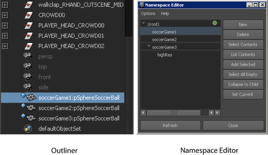

Using namespaces, you can have two objects with the same name in the same scene as long as they are contained in different namespaces. For example, in your scene you can have two objects named pSphereSoccerBall, but with different namespaces soccerGame1 and soccerGame2.

You can also nest namespaces to create a hierarchy. Namespace hierarchies start with a root namespace followed by parent and child namespaces. You can create namespace hierarchies using the Namespace Editor.

You can create and edit namespaces using the Namespace Editor. You can also create namespaces in the Reference Options window when referencing file or in the Import Options window when importing files. When you reference or import files, you can choose to use either the reference/imported file's name or specify a string as a namespace.
