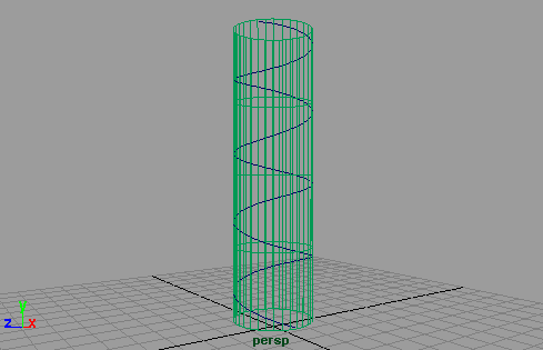

  2. Create a curve that spirals around the surface as follows:
    • Make the column live.
    • Select the CV Curve Tool.
    • Click points on the column, tumbling the view to click points around the column.
  3. Select the curve.

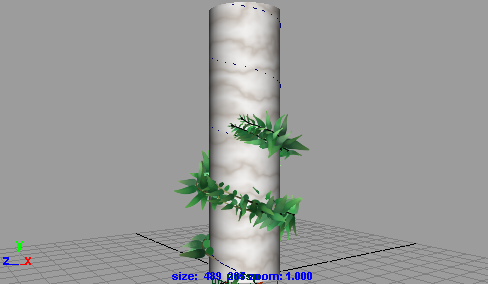

  4. In the Content Browser, select a plant preset brush from the Paint Effects > Plants folder, such as fern.mel.
  5. Select Generate > Curve Utilities > Attach Brush to Curves.
  6. Select Display > Rendering > Stroke Display Quality > 75% to improve the wireframe display quality.
  7. With the new stroke still selected, open the Attribute Editor and click the brush tab.

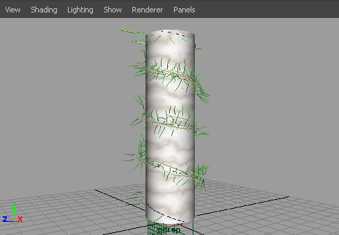

  8. Modify the brush settings until you are satisfied:
    • Increase the Global Scale.
    • Under Tubes > Creation, increase the Tubes Per Step.

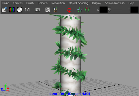

  9. Switch to the Paint Effects panel and select Paint > Paint Scene.
  10. Click the Redraw Paint Effects view icon on the toolbar to render the stroke.
  11. Animate the growth as follows:
    • In the Attribute Editor, click the brush tab.
    • Expand Flow Animation.
    • Turn on Time Clip, then change the Flow Speed value. In this example, we used 1.0.
    • In the scene view, set the playback end time to 100 and click the Play Forward button.
    • Now in the Attribute Editor, turn on Stroke Time.
    • Go to the first frame and click the Play Forward button.
  12. Render the animation. See Render a scene with Paint Effects strokes.
