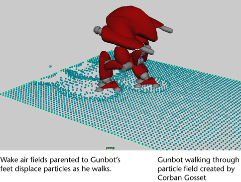

You can parent an air field to a moving part of an object to simulate a wake of air from the moving part. For example, if you have a character walking through leaves or dust on the ground, you can parent an air field to the foot.

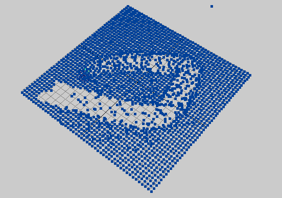

Example: Creating an air wake from a moving object
  1. Create a grid of particles or nParticles.
  2. With the particles selected, select Fields/Solvers > Air > to display the options window.
  3. Click Wake.
  4. Click Create. When the air field is created it is connected to the particles.
  5. Create a sphere.
  6. Keyframe the sphere to move through the grid of particles (on the XZ plane).
  7. Select the wake (in Outliner), Shift-select the sphere and then select Fields/Solvers > Use Selected as Source. This parents the wake to the sphere.
  8. Play the animation.
