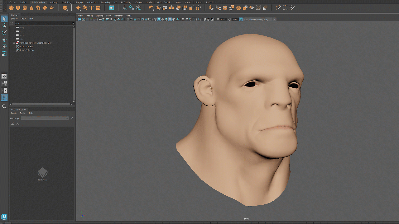

Support for blend shape import
With USD for Maya 0.29, you can now import USD blend shapes into Maya blend shapes, while preserving all the attributes.
