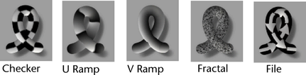

- Texture Type
This option is used only when Map Color or Map Opacity is turned on. Select the type of texture you want mapped to Color and Opacity. You can map Checker, U Ramp, V Ramp, Fractal, and File type textures. For more information on mapping file type textures, see Map file textures to color and opacity.
If you select Fractal, you can set the Fractal Amplitude, Fractal Ratio, and Fractal Threshold in this section.
If you select File, you can select the file in the Image Name box and select Frame Extension and Fringe Removal options.

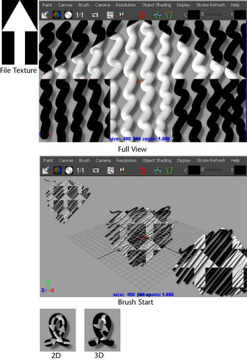

- Map Method
Select how the UV coordinates are defined for the stroke:
- Full View
The texture fits to the view. Painting tubes “reveals” the texture.
- Brush Start
The mapping is in “eyespace,” similar to Full View, but the position, scale, and offset of the texture is based on where the brush stroke starts. This texturing technique works best in scenes with Paint at Depth turned on for the brush. If the brush stroke starts far away in the scene, the texture is small. The closer the brush stroke starts, the larger the texture.
- Tube 2D
The mapping is in worldspace, but always centered on the tube such that there is never a visible seam.
The texturing follows the flow of the stroke path (U is the direction along the path, and V is the direction across the path).
- Tube 3D
The texture is fully mapped in 3D around the tube, with a seam that is visible from some views. The texture appears correctly when you animate the viewpoint.
- Tex Uniformity
The setting is used only when the Map Method is set to 2D. If Tex Uniformity is 0, the textures are stretched along the path based on how quickly the different parts of the path were drawn (or where the stroke path curve CVs are). If Tex Uniformity is 1, the texture is mapped evenly along the path.
