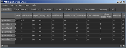

You can also select brushes with names containing a specified string of characters. For example, suppose you paint several strokes using the brush preset called grassClump. By default, each of these strokes has the brush name, grassClump1, grassClump2, grassClump3, and so on. You could select all brushes with names containing “grassClump” and quickly change the color for all of them in the Attribute Spread Sheet.

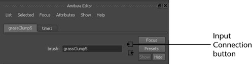

  3. Click Select Brushes. Open the Attribute Editor to view each of the selected brushes or use the Selected menu in the Attribute Editor.
