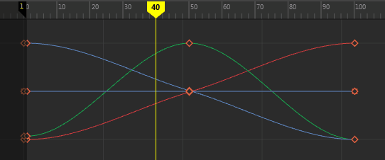

  1. Right-click the clip for which you want to change the speed and select Retime > Create and edit Speed Curve from the Time Editor Clip contextual menu. A
    The Graph Editor opens and appears next to the clip name in the Time Editor.
  2. Edit the Speed Curve in the Graph Editor. The Speed Curve displays in purple.
  3. Once you have activated the Speed Curve option, the Speed Curve options are activated in the Clip contextual menu. For a description of the Speed Curve options, see the Retime section of the Clip contextual menu.
To edit a Speed Curve
  1. Select the clip that has the Speed Curve.
  2. In the Time Editor toolbar, click the Graph Editor button to switch to the Graph Editor. See Graph Editor for information on the options available for editing curves.
  3. In the Graph Editor outliner, select the Speed Curve and click the Frame All button or press f to frame the Speed Curve.
  4. In the graph view, use the Insert Keys Tool to insert keys and use the Move Tool to adjust the curve.
    When working in the graph view with these tools, use the middle-mouse button.
    Note: You must first select the entire curve in the Graph Editor for the insert key tool to work.
