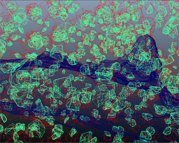

In this part of the workflow, we start with a wireframe verison of a rock face scene set up using Viewport 2.0 , that includes a mesh for the mountain base and a fractured rigid set for the top of the mountain. We are going to create an Alembic cache file of the Rigid body simulation hierarchy that can be sent to a second team, who are responsible for adding lighting and cameras. Using the Alembic workflow lets you can save time by not simulating and driving the actual objects.
To output the solve to an alembic cache file:
    Note: Currently, Bullet Alembic Export does not support workflows where the geometry has had scaling applied. Remove any scaling and/or local pivot from objects before attaching the Bullet Solver to the object.
  1. To set the scene up for export, turn off the Visibility option in the solved state node and switch the scene into Wireframe mode. You can turn on Bounding Box in the Bullet Solved Shape node for a very basic solver display.
  2. Press Play to view the simulation. Tweak the physics settings if necessary. Once the simulation is ready, we have to transfer the animation onto the original geometry that has the material and textures.

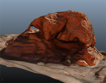

In this part of the workflow, the lighting and camera team receives the exported Alembic cache file and merges it with their version of the scene that has lights and cameras. The second team's scene contains the same hierarchy as the team that created the solve, but with no animation.
To import the alembic cache into the render file:
  1. We load a static scene with the same hierarchy but this time with textures, materials, lights, and cameras.
    Note: The render scene hierarchy does not have a namespace. If there is a namespace on the file, you need to remove it beforehand if you want to bind it to the imported cache file, as Alembic does not support importing abc files into existing namespaces.
  2. Select Cache > Alembic Cache > Import Alembic > .
  3. In the Alembic Import window, select Import Under Current Selection and Merge. This takes the animation in the .abc file and connects it with the matching objects in the new hierarchy.

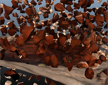

  4. Click Import. Click Play to view the solve in the rendered scene.
    Note: Once you have your scene, you can submit it for rendering or generate a playblast.
