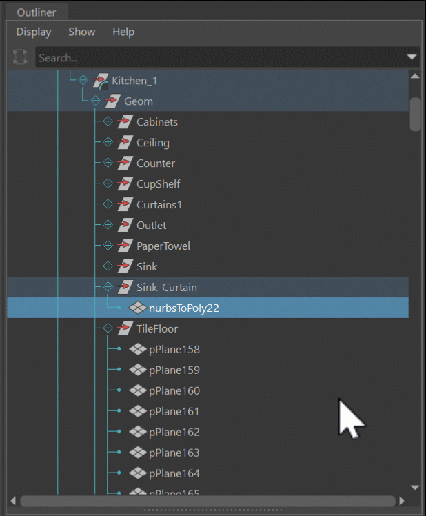

  1. Select Display > Inactive Prims to toggle the visibility of Inactive Prims in the Outliner:
![](../../../images/icon_usd_checkbox_empty.png) When Inactive Prims is unchecked, all inactive prims are hidden in the Outliner.
![](../../../images/icon_usd_checkbox_full.png) By default, the Inactive Prims display checkbox is checked. When checked, inactive prims can be seen in the Outliner.
Note: This option is saved as a user preference and will be remembered for the next time you open Maya.
Important: You cannot toggle the visibility of Inactive Prims in the Outliner if your stage is new and has not been saved to disk. Please save your stage to disk to proceed with the toggling visibility.
Important: You can delete a prim to clear it's definition. Pressing the delete key on a prim should clear it entirely. This only works if you are targeting edits to the prim's creating layer.

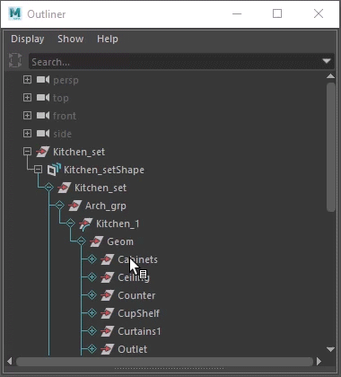

Copy and paste prims in the Outliner
You can copy a prim (Ctrl+C) in the outliner and paste it (Ctrl+V) in either of the following ways:
  • pasting the prim as a sibling of the original prim when you paste immediately after copying the prim without deselecting it.
  • pasting it as a child to another prim when you select a target prim before pasting. In either case, the pasted prim will be selected upon creation.

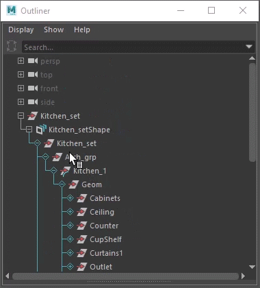

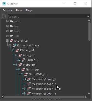

Parent prims in the Outliner
You can parent objects in the Outliner to create hierarchical relationships, letting you group prims logically. You can parent the following:
  • USD object and another USD object
  • USD object to the Maya proxy shape object
Note: If a parent prim is invisible, its descendants are also invisible (right-click the parent prim and select Make Visible to see it in the viewport). Similarly, if a parent prim is inactive, its descendants are also inactive (right-click the parent prim and select Activate Prim to activate).
Important: Parenting geometric prims (Gprims) to one another is not allowed. Similarly, reparenting under an instance is not allowed. Many key features of USD apply hierarchically, such as activation, visibility and purpose. It is counter-productive to be unable to apply these operations to individual Gprims.
  1. To parent prims, do one of the following: - Middle-click drag and drop a prim to re-parent it. - Shift-select multiple prims and press P. The last prim you selected becomes the parent.
  2. To unparent a prim, do one of the following: - Parent the prim to the root of your stage - Select the prim you want to remove from the parent group, and press Shift+P

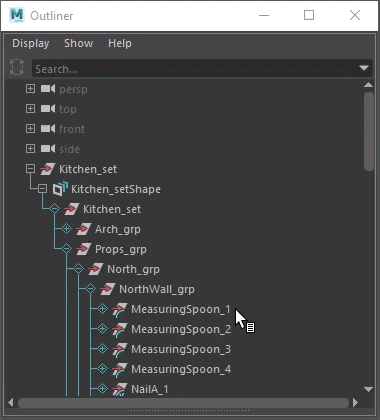

Cut prims in the Outliner
You can cut a prim (Ctrl+X) if it does not have any opinion on another layer. When a prim has an opinion on another layer, the cut will be blocked and you will not be able to paste it.
When you attempt to cut multiple prims and some of them are blocked (due to having an opinion on another layer), only the unblocked prims are cut and available for pasting. If you proceed to paste, only the unblocked prims will be pasted, while the blocked ones remain in their original position.

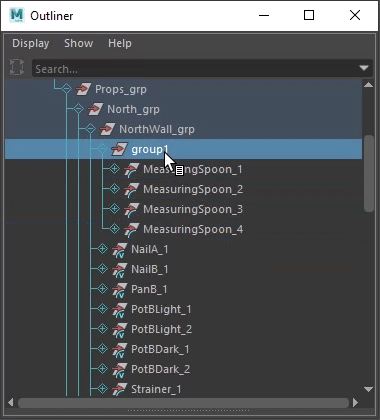

Group prims in the Outliner
  1. To group prims, Shift-select the prims you want to group together.
  2. Do one of the following:
-    Select **Edit > Group**
-    Press **Ctrl + G**
The prims are nested under a new prim called `group`.
