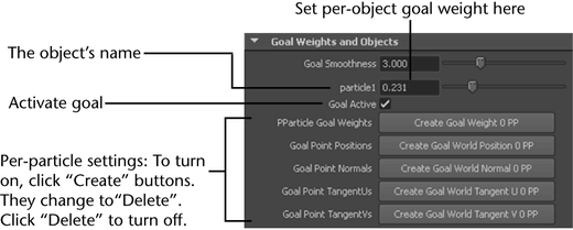

To change the goal weight in the Attribute Editor
- Select the particles (or soft body particles) affected by the goal.
- Display the Attribute Editor.
- Open the
Goal Weights and Objects section.
The goal weight is next to the name of the goal object. Change this weight to apply to the entire object.
(If you change any of the per-particle settings, this goal weight will no longer apply.)
If the particle object has multiple goal objects, you’ll see a goal weight section for each object.
Tip: In the Channel Box, the goal weight for the first goal object you added is Goal Weight[0]. The second is Goal Weight[1] and so on.

To set up per-particle goal weight attributes
- Ensure that you’ve created a goal for an object to which the particles are attracted. ( ). For more information, see Create goals.
- In Component mode, select the individual particles for which you’d like to edit per-particle goal weights.
- In the particle system node of the Attribute Editor, go to the Goals Weights and Objects section and click the Create goalWeightNPP button for the desired goal object.
