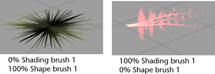

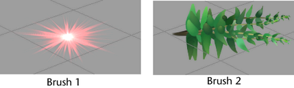

By blending the tube shading and shape attributes of two preset brushes, you can create new and interesting (sometimes unexpected) effects.
For example, suppose you like the shading used for one brush, but you like the shape of another. You can blend the brushes so that the new brush uses 100% of the shading of the first brush, and 100% of the shape of the other.
For more interesting effects, you can change the percentage of the shading and shape of each brush used in the blended brush.
