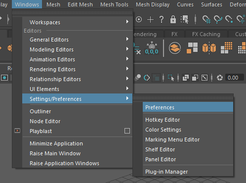

To change Maya's default unit of measurement
- In the Maya menu bar, go to
Windows>Settings/Preferences >
Preferences.
- In the Settings category, locate Working Units.
- In the
Linear drop-down menu, select your preferred working unit.
