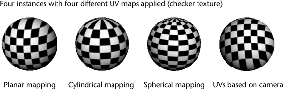

While you could always associate different instances of a particular shape with different materials, you can now associate different UV sets with different instances. This is very useful when baking shadows on instances of an object (for example, lighting a game level), or creating instances of a single shape with different textures (for example, a pile of boxes, some with holes in different locations, and so on).

  6. Select a UV mapping type under the Create UVs menu (such as Planar, Cylindrical or Spherical). Make sure that Create New UV Set is disabled in the mapping’s option window.
    A new UV map is create for the selected instance that shares the name of the current set.

Different (per-instance) UV mappings should now be displayed on your instanced objects when you render them or display them in the scene view with Hardware texturing.
