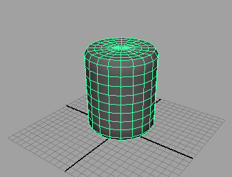

Create an nCloth can
This is the base model for the can and the input mesh for your rigid nCloth.
To make the soda can model nCloth.
  1. In the FX menu set select the can and select nCloth > Create nCloth.
  2. In the Attribute Editor, select the nucleus1 tab.
  3. In the Ground Plane section turn on Use Plane.

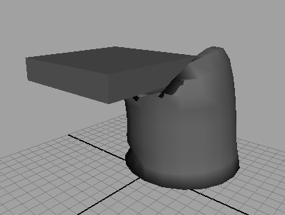

Crushing the can
The soda can is now configured to react like an aluminum can. You can now crush it.
To crush the soda can
  1. Select Create > Polygon Primitives > Cube.
    A polygon cube appears at the origin. The cube is obscured by the can when it is initially created.
  2. Select the Move Tool from the Tool Box and move the cube up so that it rests above the can.
  3. Select the Scale Tool and scale the cube so that its length and width are the same as those of the can.
  4. Select nCloth > Create Passive Collider.
  5. Select the Move Tool from the Tool Box.
  6. In the FX menu set, select Fields/Solvers > Interactive Playback.
  7. As the scene plays, move the cube into the can at various angles and speeds.
    As you move the cube down the can deforms. You can experiment by hitting the can from the side or on an angle to see different deformations. If you find the animation is resetting before you can experiment completely, increase the playback end time.
