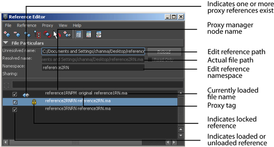

When a proxy reference is first created a proxy set is also created. When the proxy set is created, the original file reference as well as the selected proxy reference are organized under a new proxy manager node. You can then select which file (the original reference or the proxy reference) to load in the scene using the Reference Editor or by right-clicking an object in the scene and making the appropriate selection from the marking menu.
Reference Editor
When a proxy reference is added to an existing file reference, the original reference becomes a proxy reference within the new proxy set. In the Reference Editor, an icon is displayed to indicate the existence of one or more proxies for the reference, and the name displayed in the Reference Editor reflects the proxy manager that is created.
