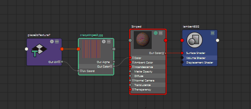

Default Node View Mode
Choose a default view for Hypershade nodes to display in the Hypershade Work Area.
You can change the view mode for each node by clicking the (simple), (connected), (full), or (custom) icons on the top right corner of each node. Click 4 to view all attributes if you do not have a custom attribute view saved.
  • Simple Mode: Set the view mode of nodes to simple mode so that only the input and output master ports are shown.
  • Connected Mode: Set the view mode of nodes to connected mode so that the input and output master ports, as well as any connected attributes, are shown.
  • Full Mode: Set the view mode of nodes to full mode so that the input and output master ports, as well as primary node attributes, are shown. The set of primary attributes for a given node is based on the properties of the attributes such as whether they are keyable or dynamic.
  • Custom Mode: Set the view mode of nodes to custom mode so that nodes display in their custom attribute view. You can create a custom attribute view for each node by right-clicking the node and selecting Edit Custom Attribute List. See Customizing the list of node attributes for more information.
    Note: If you select Custom Mode as your Default node view mode, then any node that does not have a custom attribute view saved displays in its full mode.
