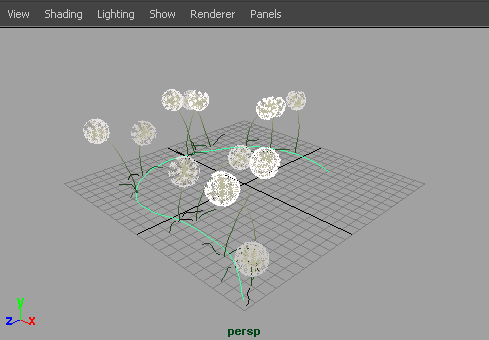

When you paint on the grid of the perspective view, the stroke lies on that plane.
To paint on the grid plane of the perspective view

- In either the scene view or the scene painting view, drag across the plane.
