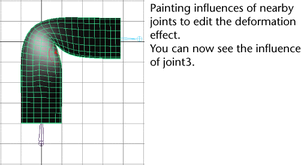

To paint creasing effects
  1. Select smooth shaded display mode (hotkey: press 5).
  2. Select the cylinder.
  3. Select Skin > Paint Skin Weights > to open the Paint Skin Weights Tool .
  4. In the Tool Settings window, theInfluence section should be displayed. For more information, see Skin > Paint Skin Weights.
  5. Note the Transform box.
  6. Click a joint name. For example, click joint3.
  7. In the Influence box, click another joint name. For example, click joint4.
  8. Check the influence of one more of the joints. For example, check the influence of joint2.
  9. Use the Paint Skin Weights Tool to paint how the joints influence creasing.
