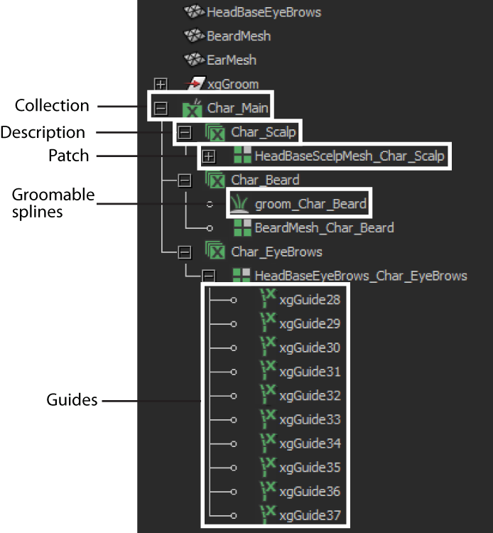

The XGen hierarchy appears in the Outliner as follows:
