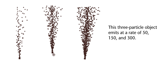

You can use a different emission rate for each particle, CV, vertex, edit point, or lattice point of Omni or Directional point emitters. For example, you can emit a ring of fire from a circle’s edit points and vary the emission at each point to enhance the irregularity found in natural fire. You cannot vary emission on a per-point basis for objects whose Emitter Type is either Surface or Curve.
To vary emission from particles
- Create and select the emitting particle object.
- Select
This creates an attribute named emitterRatePP for the particle object that emits. This attribute lets you vary emission rates on a per particle basis.
- In the Attribute Editor, open the Per Particle (Array) Attributes section.
- Without breaking the connection to
emitternameRatePP, right click the
emitterNameRatePP box and select the desired method to set its value. See
Work with per-particle attributes.

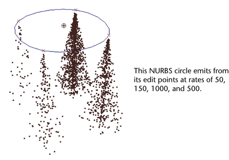

To vary emission from a NURBS or polygonal point emitter
- Finish modeling the geometry before adding a point emitter.
- Select the emitting geometry.
- Select .
- Select the emitting object’s shape node.
- In the
Extra Attributes section of the
emitterName Rate PP section.
For the emitterNameRatePP attributes, enter values in the Attribute Editor boxes corresponding to the CVs, vertices, edit points, or lattice points. To learn which box corresponds to a point, experiment with a large value in a box. You can also use an expression, ramp, or Artisan to set individual rates.
Note: If you add CVs, vertices, or edit points after you add and tune per-point emission rates, you can select Per-Point Emission Rates a second time to set the additional entries for emitterNameRatePP. However, the Attribute Editor emitterNameRatePP entries no longer correspond to the same identifiers for CVs, vertices, or edit points. You’ll need to correct the emitterNameRatePP entries.If you delete CVs, vertices, or edit points, delete the emitter, create a new emitter, and choose Per-Point Emission Rates again.
