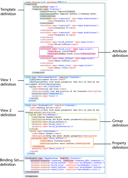

The following diagram shows a sample template file with two views, and illustrates the placement of the XML elements within the template file.

Main elements
The main body of the template is defined by a single <template> element. Within the template, a series of <attribute> properties describe the published attribute interface of the asset.
The following table describes the main elements of a template file.
Element Description
<encoding>
Must be UTF-8. If the encoding is not specified, UTF-8 is assumed.
Note:
Files containing only ASCII characters are UTF-8 compatible.
<templates>
Encloses all file elements.
<package>
(Optional) If a template is part of a named package, this attribute specifies the package name. See Template Packages for more information.
<using>
A <using> statement should be included to identify all packages required by the file. Maya automatically adds <using> directives to templates created or saved from Maya.
<template>
Encloses all elements within the template file. Usually there is one template definition per file. See Template elements.
<view>
(Optional) View elements define customized user interface layouts for the template. Multiple views can be associated with each template. See View elements.
<bindingset> (Optional) Bindingset elements define a binding set for a template used for Autobinding other assets which use the same template. A binding set defines a mapping from published names to nodes in the asset.

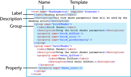

View elements
A template can have one or more views associated with it. A view describes a particular display layout for the asset and can be used to tailor the interface for different purposes (for example different users or workflows).
Views are defined using <view> elements. The attributes in a view are referenced from the template using <property> elements. Attributes can be grouped using <group> elements. View-specific overrides can optionally be supplied for certain template information. In particular, the attribute’s label and description text that is displayed in the interface can be customized on a per-view basis if desired.
A view element defines a customized user interface layout for the contents of the template. When the view is active, only those attribute properties included in the view definition are shown in the user interface, and the other template attributes are suppressed. The view properties can be organized into groups.
Some information (labels, descriptions) can be provided on both the template and the view. View-specific definitions take precedence over template-level information when they are provided.
ELement Description
<name>
Provides a name for this view. The view name is an identifier and cannot contain spaces, special symbols, or multi-byte characters. To provide a user-interface label for the view, use the <label> attribute.
<template>
Identifies the template with which this view is associated.
<label>
(Optional) Display label for the view. If the label is not specified, the view name is used. This value can be localized. See Localization elements: Interface labels and descriptions for more information.
<description>
(Optional) Annotation text for the view. This text displays in some parts of the interface (such as the Attribute Editor) as tooltip help. See Localization elements: Interface labels and descriptions for more information.
<property>
Views contain a series of property elements which refer to template attributes. See Property elements.
<group>
Properties can be organized into groups. See Group elements.
Example code:
<view name='ShadingArtist' template='fountain'>
	<label>Shading Artist</label>
	<description>This view is for the shading team. 	</description>
	<group name='Water_Shader'>
		<property name='water_diffuse'/>
		<property name='water_color'/>
	</group>
</view>

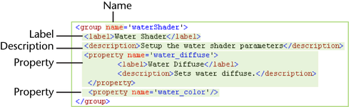

Group elements
Views can contain group elements. Groups organize the attributes in the windows and editors of Maya. In the Attribute Editor and Asset Editor for example, groups are used for creating collapsible layouts. In some cases, the use of groups is not supported (such as in the Channel Box) and the view properties are laid out in an ordered list instead.
Note:
Groups can be nested.
The following table describes all elements that are allowed within a group definition.
Element Description
<name>
Provides a name for this group. The group name is an identifier and cannot contain spaces, special symbols, or multi-byte characters. To provide a display label for the group, use a <label> element.
<label>
(Optional) Display label for the group. If the label is not specified, the group name is used. This value can be localized. See Localization elements: Interface labels and descriptions for more information.
<description>
(Optional) Annotation text for the group. This text is used in some parts of the interface (such as the Attribute Editor) as tooltip help. See Localization elements: Interface labels and descriptions for more information.
<property>
Groups contain a series of property elements which identify the template attributes included in the group.
Example code:
<group name='Brick_Shader'>
	<label>Brick Shading Properties</label>
	<description>Control main brick shader.<description>
	<property name='brick_diffuse'/>
	<property name='brick_color'/>
	<property name='brick_transparency'>
</group>

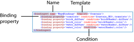

Binding Set elements
A template can have one or more binding sets associated with it. A binding set is a mapping of published names (binding properties) mapped to node attributes (conditions). This mapping is used by the Autobind feature to quickly publish and bind attributes in any asset that uses this template.
Element Description
<name>
Provides a name for this binding set. The binding set name is an identifier and cannot contain spaces, special symbols, or multi-byte characters. The default name when a binding set is created is ‘MayaBindings’.
<template> Identifies the template with which the binding set is associated.
<binding property> Defined a name that is to be mapped to an attribute inside the asset.
<condition> Refers to an attribute in the asset. If the Autobind command is issued and Maya finds this attribute in the asset, then Maya publishes it and binds it to the name defined by the corresponding binding property.
You can input actual attribute names or regular expressions here. For more information on regular expressions, see Using regular expressions.
