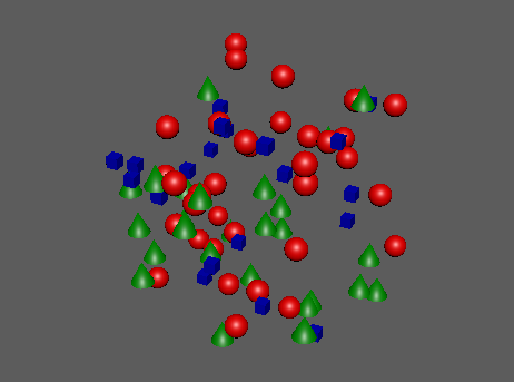

Allows you to assign different objects to MASH points.
Note: Should be added to the Instancer's ID channel.
ID Node
- ID Type
The type of ID distribution. Options include:
- Linear: Increments the ID of each object by 1. Loops if there are not enough objects.
- Random: Each object gets a random ID. You can adjust the probability of certain IDs of certain IDs showing up over other IDs using the Probability Ramp.
- Cycle: IDs are incremented per frame.
- Fixed: Each ID is the same.
- ID Count
- Specifies how many object IDs to issue. By default, this is set automatically based on the ID Type, though you can right-click and break the connection to set it manually.
- Random Seed
- Changes the randomization when ID Type is set to Random.
- Fixed ID
- Sets a specific ID number when ID Type is set to Fixed.
