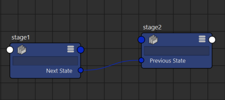

  3. Create two stage nodes.
  4. Connect stage1's Next State attribute to stage2's Previous State attribute.

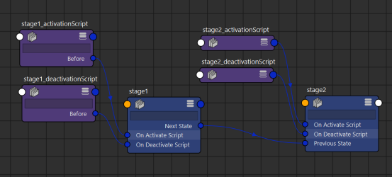

  5. In each stage's On Activate and On Deactivate attributes, enter the Python code you'd like to execute when the stage begins and ends (either directly in the field, or by connecting a script node set to Python mode).

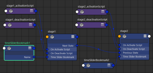

  6. (Optional) Connect a Time Slider Bookmark node to the stage nodes to automatically frame those bookmarks when the stage is activated.
