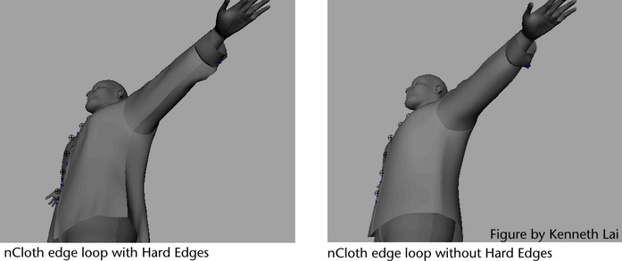

To create ridges on nCloth that resemble creases or seams
  1. Select the nCloth object (output mesh) on which you want to create a ridge to mimic a seam or crease.
  2. Select Edge component selection mode.
  3. Double-click one of the edges in the row of edges you want to crease.
    All the edges in the row or loop are now selected.
  4. In the Polygons menu set, select Mesh Display > Harden Edge.
    The edge loop you hardened is now a ridge that resembles a seam or crease on the nCloth object. This ridge retains its shape during its nCloth’s simulation.
