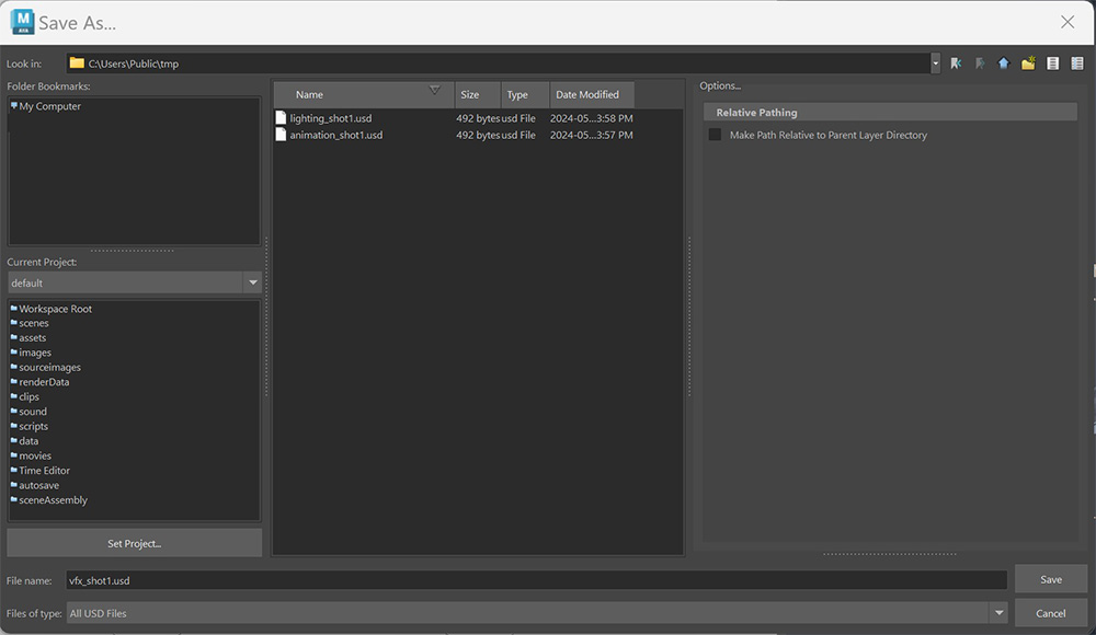

To save an anonymous layer, right-click on the layer and select Save As, or double-click on the layer.
In the file browser that appears, set the following:
File name: Enter a name manually or select the name of an existing file
Files of type: Select .usd, .usda, or .usdc file format from the Files of Type drop-down menu
Type Format .usd generalized format in which you can specify between Binary (default) or ASCII .usda optimized for human readability, ASCII only .usdc optimized for machine readability, Binary only
Important: If you have Windows > Settings/ Preferences > Preferences > Files/ Projects > File Dialog set to OS Native, you will see your operating system's file browser instead of this dialog.Once you name any applicable anonymous layer (and the Maya scene file has been saved to disk), under File Options, you can select
Make Path Relative to Parent Layer Directory. With this toggle, you can load and save USD sublayer files as relative to your parent file directory and also save an anonymous root layer file as relative to your Maya scene file. To learn more about saving USD files relatively, see Make Path Relative. Click Save.
The name of the anonymous layer is updated and the asterisk disappears, indicating that there are no longer unsaved edits on the layer.

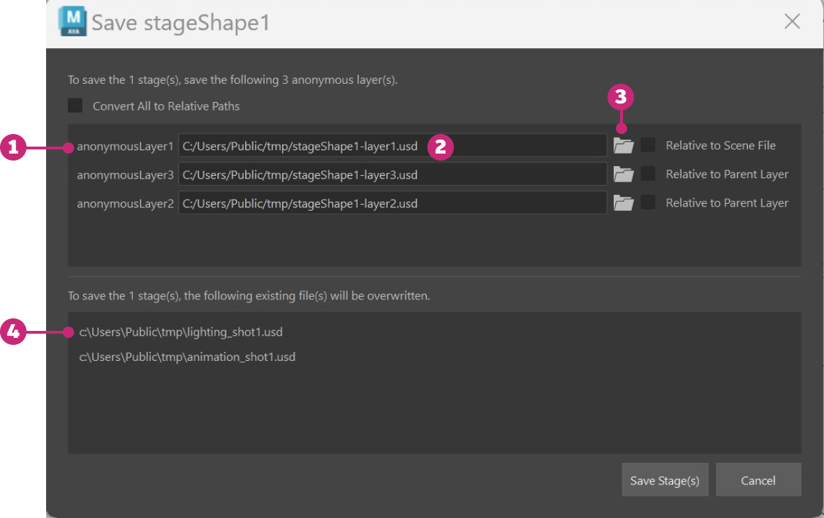

If you have unsaved edits on multiple layers in your Layer Stack, you need to save those layers to disk before you can save the stage. When you have unsaved edits to multiple layers, you will recieve the following dialog (or a portion of it - depending on if your layers are existing or new):
| # | Element | Description |
| 1 | Anonymous Layer(s) Save | This section of the Save Stage Dialog appears when you have edits to anonymous or newly created layers. |
| 2 | Anonymous Layer File Name | Anonymous layers have not been saved to disk so Maya will autopopulate a file name for the save operation in the syntax of stageName-layer#. |
| 3 | Anonymous Layer Save Path | Click the folder icon to choose the location for saving your anonymous layer to disk. |
| 4 | Existing Layer(s) Save | This section of the Save Stage Dialog appears when you have unsaved edits to existing (ie. file-backed) layers. This section exists as a confirmation of the layers being overwritten with edits. |
Click
to set the save location on disk. The toggle next to this icon allows you to save USD sublayers as relative to your parent file directory or save an anonymous root layer as relative to your Maya scene file. To learn more about saving USD files relatively, see Make Path Relative. Click Save Stage.
