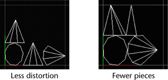

Optimize for
Sets the optimization type for the automatic projection.
Less distortion
Projects all planes equally. While this method provides the best projection for any face, you may end up with more shells. It is particularly useful if you have a symmetrical model and you want the shells of the projection to be symmetrical.
Fewer pieces
Projects each plane until the projection encounters a projection angle that is not ideal. This can result in larger shells, and fewer of them. This is the default.

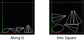

Along U
Positions the shells along the U axis.
Into Square
Positions the shells within the 0 to 1 texture space. This is the default.

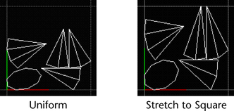

Uniform
Scales the shells to fit the 0 to 1 texture space without changing the aspect ratio. This is the default.
Stretch to Square
Stretches the shells to fit the 0 to 1 texture space. The shells may become distorted.

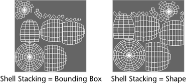

Shell stacking
Determines how the UV shells get stacked in relation to each other when laid out in the UV Editor.
Bounding Box
Creates a rectangular bounding box around each UV shell, then stacks the shells based on the borders of the bounding boxes. The UV shells will have more space between them when this option is set.
Shape
Stacks the UV shells based on the boundaries of each individual shell. The UV shells can be more tightly arranged to fit into any available spaces when this option is set.
