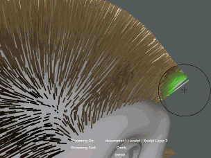

Tip: You can access a sub-set of these options in the marking menu by right-clicking when the brush is active.
- Lock Selection
- Specific to the
Comb Brush When on, only hairs in the brush radius are affected as you drag in the direction you want to orient and bend the hairs. This option is off by default.

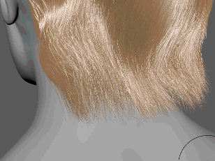

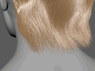

Lock Selection: Off
Lock Selection: On
