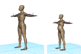

You can import weight maps to a smooth-skinned surface in another scene so that its skin deforms the same as the first surface. The surface in the second scene must have the same UV orientation as the original surface, but it can differ from the original as follows:
  • It can be scaled differently but must be proportioned similarly in regions of significant deformation, typically around joints.
  • It can have a different number of spans and sections.
  • It can have a different world space position.
    For example, if you export the smooth skin weight maps from the character on the left to the smaller, pregnant character on the right, the skin deforms the same on both. This saves you time painting weights on the pregnant character.
