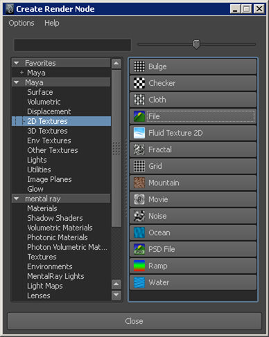

- In the Fluid Attributes section, click the icon for the type of emission you want to use.
For example, to emit density using an emission map, click the
icon to the right of Density Emission Map. The Create Render Node window appears.
- In the Create Render Node window, under Maya, select 2D Textures from the list.
- In the right panel, click the 2D texture you want to use.
For information about textures, see 2D and 3D textures.
