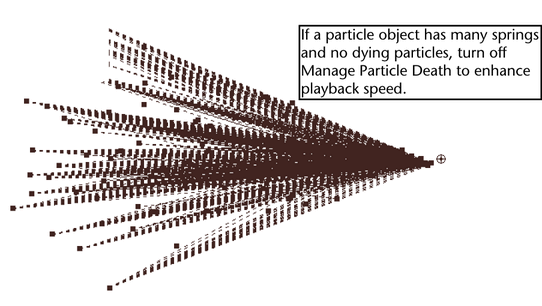

An animation with many springs plays slowly
If the age of any or all particles exceeds the lifespan, Maya removes the particles from the object. For brevity, we describe such particles as dying particles. If a scene has a particle object with many springs and no dying particles, the animation plays needlessly slow because of complex calculations. You can turn off the attribute Manage Particle Death to eliminate the calculations and enhance the playback efficiency.
In short, it’s helpful to turn off Manage Particle Death for the spring object associated with the following objects if they have undying particles:
- soft bodies
- objects made with the Particle Tool
- emitted particles
Do not turn off Manage Particle Death if any particles in the object die. Springs attached to the particles won’t work correctly. This is true if particles have ever died in the object. If you set current attribute values of the particles for initial state operation at a point where no more particles die, you still must not turn off Manage Particle Death.
To turn off Manage Particle Death, select the spring object and display the Attribute Editor. Turn off the Manage Particle Death attribute in the Spring Attributes section.
