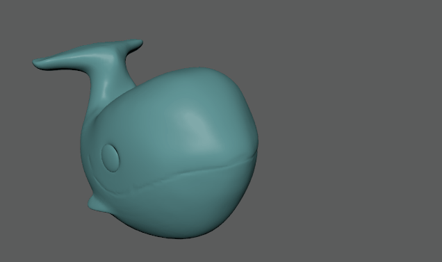

    • In the following example, Division levels is set to 1 and Keep original is turned on.

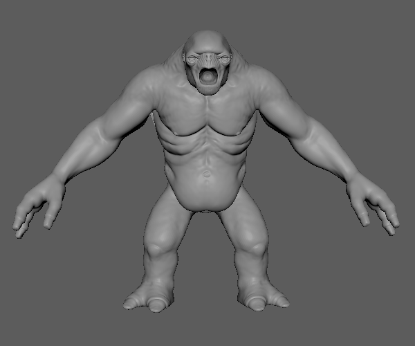

      Model provided by: Christoph Schädl
