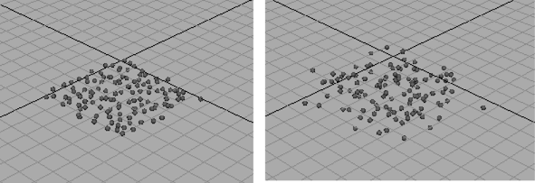

Suppose you’ve created a grid of 121 particles.
Suppose further you create this runtime expression for its acceleration attribute:
particleShape1.acceleration = sphrand(2);
The expression executes once for each of the 121 particles each time the runtime expression executes.
The sphrand(2) function provides a vector whose randomly selected components reside within an imaginary sphere centered at the origin and with a radius of 2. Each particle receives a different vector value. For details on the sphrand function, see sphrand.
Because each particle receives a different random vector for its acceleration each frame, the particles accelerate individually in a constantly changing direction and rate as the scene plays. This gives the acceleration abrupt changes in direction.

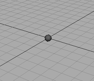

Suppose you’ve set your animation’s starting frame to 0, and you’ve used the Particle Tool to place a single particle at the origin:
You then create a runtime expression to control its position:

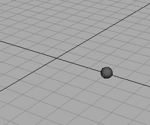

particleShape1.position = <<3,time,0>>;
When you play the animation, the runtime expression takes control of the attribute. In the first frame that plays, the particle jumps to <<3, time, 0>>. At the default frame rate of 24 frames/second, the position is <<3, 0.0417, 0>>, because the value of time is 0.0417.
Each subsequent frame moves the particle upward at a rate set by the incrementing value of time.
When you stop and rewind the animation, the particle moves back to the origin, the particle’s original position when you created it with the Particle Tool. When you created the particle, Maya stored its original position in an internally maintained initial state attribute named position0. For details, see Understand initial state attributes.
Because the attribute has no creation expression controlling its value, Maya sets the attribute to its initial state position0 value of <<0,0,0>>.
