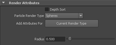

You can also add default dynamic attributes for tuning particle render types (see Add dynamic attributes to nParticles). For example, suppose you select a particle object and display the Render Attributes section of the Attribute Editor. If you select Spheres as the Particle Render Type then click the Add Attributes For Current Render Type button, Maya adds a Radius attribute. The Radius attribute appears at the bottom of the Render Attributes section:
