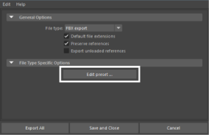

  1. Select File and click the option box next to Import, Export All, or Export Selection.
    The Options dialog box appears.

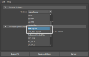

  2. Select FBX export from the General Options File type menu.
    File type menu
    The Edit Preset button appears in the File Type Specific Options.
  3. Click Edit Preset to show the Export/Import Options dialog box.

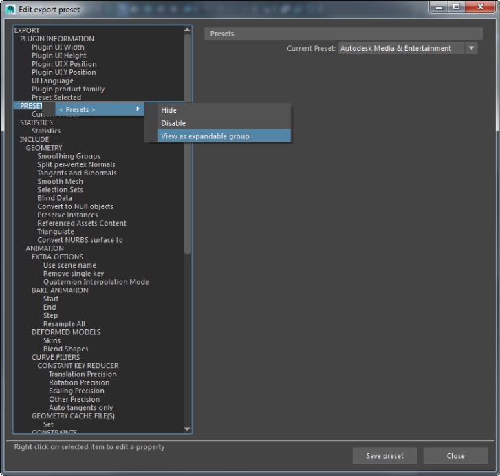

    The Edit Preset dialog box is split into two sections, with a tree view of the FBX options in the left section.
  4. Select, then right-click elements in the Tree View to access the Edit options. See Edit mode options.
    Note: Some edit options are common to all structure levels, while some are specific to a particular structure level. You can apply some options at any level of the options structure. See Edit mode options.
  5. Click Save preset.
  6. In the Saving new preset dialog box that appears, type the name of the new preset. For example, “MyNewPreset”.
    The new preset appears in the Maya FBX plug-in the next time you load Maya.
