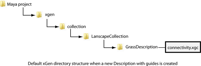

The first time that you create a new Description, Maya creates an xgen folder in the set Maya project directory. By default, all XGen-related files, including Description XDSC files, point XUV files as well as Ptex files used for attribute maps, groomable splines, region maps, and masks, are stored in sub-folders within the project's xgen folder.
A ${DESC} variable specifies the main data path to the current Description. By default, this data path is set to the xgen folder for the Collection containing the Description. XGen uses this data path to access all the files and maps when the Description is previewed or rendered.
For example, after you set your Maya project and created the following:
- A Description named GrassDescription and a Collection named LandscapeCollection.
- On a polygon mesh named landScapeplane.
- Using guides to place the primitives.
Maya generates the following default data structure for XGen.
See Map file locations for information about locations of Ptex and Point maps.
