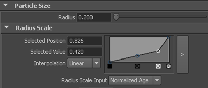

For example, on the Radius Scale ramp, when you select a Radius Scale Input, such as Normalized Age, the dynamic per-particle attribute is updated, and the input and output connections are made. nParticle Radius is now determined by the ramp's output and applied to particles on per-particle basis according to their normalized age.

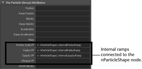

If you select Off from the Radius Scale Input, the connections between the input and the output are broken, and if the output attribute is a dynamic attribute, it will be deleted. Be aware that the dynamic attribute is deleted even if it was originally created using the some other method, such as using Add Dynamic Attributes. You can view the Per Particle (Array) Attributes to verify which internal per particle ramps are currently being used by the selected nParticleShape node.
If you want to control these per-particle attributes using an expression, you must first delete them by setting the Input Scale attribute on the respective ramps to Off.
