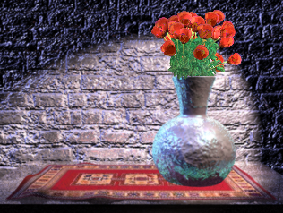

Shadows work with lights to add realism to your scenes. Shadows help to define the location of objects, whether they rest on the ground or hover in space, for example. Shadows can be soft-edged or hard-edged, and their presence (or absence) can be used to add balance and contrast to objects in your scene.
To create a shadow, a scene must contain a shadow-casting light, a shadow-casting surface, and a shadow-catching surface. The light must illuminate both the shadow-casting surface and the shadow-catching surface.
