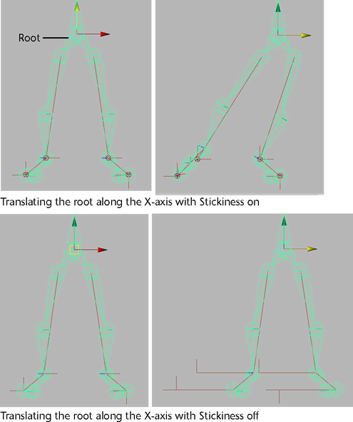

- Stickiness
When this attribute is on and the current IK handle has no keyframes, the current IK handle will stick to its current position when you pose the skeleton with another IK handle or by translating, rotating, or scaling the joints directly. When this attribute is on and there are keyframes on the current handle, Stickiness is ignored. Default is off.
You can use Stickiness when posing a joint chain with an IK handle to prevent unwanted joint chain movement. For example, you can turn on Stickiness for the IK handles of a model’s legs if you want the feet to stay firmly planted on the floor while you move and pose the hips of the model.

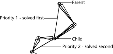

- Priority
Specifies the priority of the current IK handle. Priority is useful only when a joint chain has more than one IK handle. The purpose of Priority is to ensure that the IK handles of a joint chain solve in the correct order so that they properly produce the desired animation.
When you set Priority for the IK handles of a joint chain, Maya calculates the priority for each handle based on its position in the hierarchy. The IK handle with a Priority of 1 has first priority, and will rotate the joints first. An IK handle with a Priority of 2 has second priority, and will rotate the joints next, and so on. Default is 1.

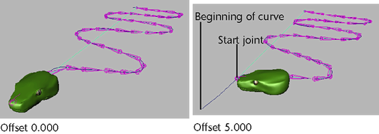

- Offset
This attribute is only available for spline IK handles and when Root On Curve is on.
Sets the amount the root of the IK chain’s start joint is offset from the beginning of the spline IK curve.

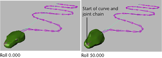

- Roll
This attribute is only available for spline IK handles.
Rolls the entire joint chain from the start joint of the spline IK handle.

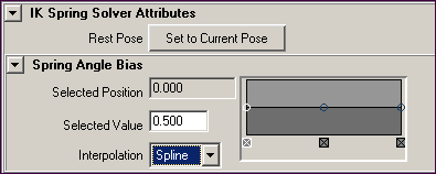

IK Spring Solver Attributes
Rest Pose
The rest pose sets the basic appearance of a spring IK joint chain. The rest pose also determines how angle biases are calculated across a spring IK joint chain.
By default, the rest pose is the pose (orientation and position of joints) of the spring IK joint chain at the time of its IK handle’s creation.
- Set to Current Pose
Sets the current spring IK joint chain’s pose as its IK handle’s rest pose.
Spring Angle Bias
- Selected Position
Displays the position of the angle bias icon on the Spring Angle Bias ramp. This field is read-only.
- Selected Value
Specifies the bias value for the selected angle bias icon. The angle bias is a relative weight that determines how fast a joint rotates in relation to the other joints in the same chain. The angle bias functions as a multiplier, influencing the angles between the bones in the target joint chain.
For example, if the Selected Value of the first angle in the joint chain is 1, and the second angle in the chain has a Selected Value of 0, then the first angle moves twice as fast as the second angle.
The minimum Selected Value is 0 and the maximum is 1.
- Interpolation
This attribute is inherited from the ramp node and it has no effect on the spring IK solver.

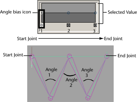

- Spring Angle Bias ramp
Displays the relationship between the current spring IK joint chain’s angle biases (Selected Values) and their target angles (angles between bones). The icons on the ramp represent the current spring IK joint chain’s Selected Values. The positions of these icons on the ramp are determined by:
- On the vertical axis, the current angle biases (Selected Values) of the icons.
- On the horizontal axis, the order in which the angles between bones occur (from start joint to end joint) in the spring IK joint chain.
For example, for a spring IK joint chain with five joints, three icons appear on the Spring Angle Biasramp. The first icon along the ramp’s horizontal axis represents the Selected Value for the target angle nearest to the spring IK joint chain’s start joint.
