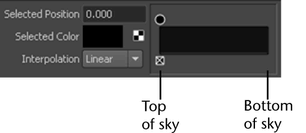

- Environment
The Environment ramp defines a simple sky to ground environmental reflection on a surface. The left of the ramp represents the top of the sky and the right represents the bottom.
You define the reflection colors between the top and bottom of the sky by adding position markers to the ramp and changing the color at the markers. See Set fluid attribute ramps.
- Selected Position
This value indicates the position of the selected color on the ramp (between 0 on the left to 1 on the right).
- Selected Color
Indicates the color on the ramp at the selected position. To change the color, click the Selected Color box and select a new color from Color Chooser.
