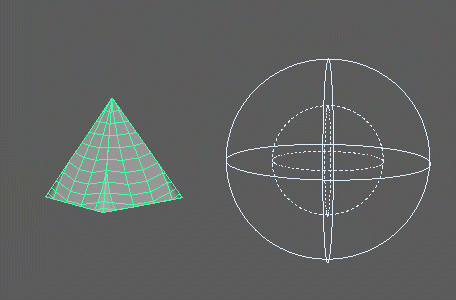

Blends the connected mesh to another version of the same mesh. However, unlike a regular Blend Deformer, this blend can interact with MASH falloff objects, maps, etc. It does not require a MASH network to use.
Blend Deformer
