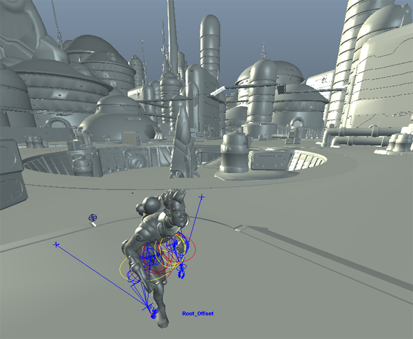

Simply put, a scene built with Scene Assembly lets you swap multiple representations of a production asset. When your task requires fast loading and optimal playback, use a Cache representation of a production asset. When a scene requires high-resolution geometry for rendering, use a Scene representation. This workflow is extendable to large hierarchies of production assets containing massive data sets, such as a complete city layouts. When working with complex assemblies, you still have quick access to all the representations of individual objects.
Use Scene Assembly in your animation workflows by adding animation curves and constraints to the representation versions of your production assets. With Scene Assembly rendering options, you can quickly setup low-resolution representations for test renders and lighting tests, which can be easily switched to high-resolution representations of your assets for final renders.
