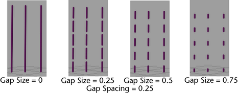

- Gap Size
Defines the size of the gap, relative to the Gap Spacing. If the Gap Size is 0, there are no gaps. If the value is 1, there is nothing but gap.

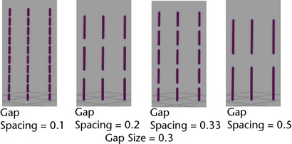

- Gap Spacing
Defines the space between gaps, expressed as a proportion of the length of the tube. For example, if Gap Spacing is 0.33, then the gaps divide the tubes into 3 parts.
