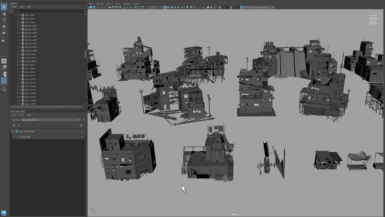

Bulk editing: load/unload multiple prims
In USD for Maya 0.26, the bulk action context menu lets you make multiple prims visible, activate them or mark them as instanceable. With the 0.27 update, you can also load or unload multiple prims simultaneously.
