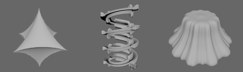

Super shapes are primitives based on cubes and spheres that are capable of creating complex organic shapes. However, due to the highly mathematical nature of these shapes, we recommend creating a base shape with the default values and then experimenting with the Random button in the associated superShape node to get a shape close to what you desire. You can then use the Attribute Editor to tweak that shape.
A polySuperShape node is created whenever a super shape primitive is created.

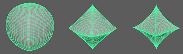

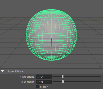

Super Ellipse
A Super Ellipse generates primitives using an exponential equation along x and y, resulting in arcs or inverse arcs along each axis.
This section contains attributes specific to the Super Ellipse Shape.
- V Exponent
Controls the exponent used to calculate the parabolic arc along the vertical.
- H Exponent
Controls the exponent used to calculate the parabolic arc along the horizontal.
- Mirror
- Forces the H Exponent to match the V Exponent.

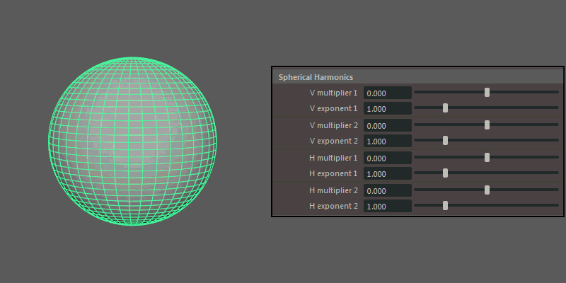

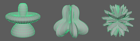

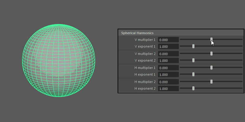

Spherical Harmonics
Spherical Harmonics apply a series of frequency equations to the surface of a sphere, resulting in pulsing topology.
This section contains attributes specific to the Spherical Harmonics Shape.
- V multiplier, V exponent
Controls the mathematical variables used to determine the shape along the vertical.
- H multiplier, H exponent
Controls the mathematical variables used to determine the shape along the horizontal.

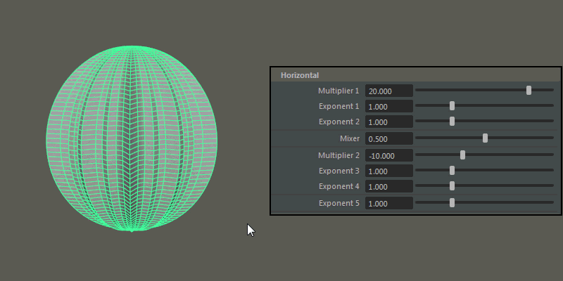

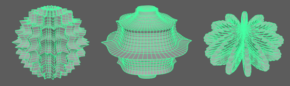

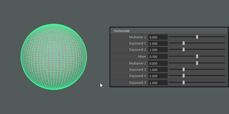

Ultra
This section contains options specific to the Ultra Shape. Ultra shapes use an algorithm specifically designed to create organic-looking shapes.
Horizontal
Controls the pattern across the ultra shape's latitude.
- Multiplier 1, Multiplier 2
Controls the main horizontal protrusions from the ultra shape. Both values can exist on the ultra shape at once, and you can blend between them using the Mixer attribute.
- Exponent 1, Exponent 2, Exponent 3, Exponent 4
Controls the extent of the horizontal extrusions for Multiplier 1 (Exponent 1 and 2) and Multiplier 2 (Exponent 3 and 4) respectively.
- Exponent 5
- Controls the overall extent of the horizontal protrusions resulting from the previous Multipliers and Exponents.

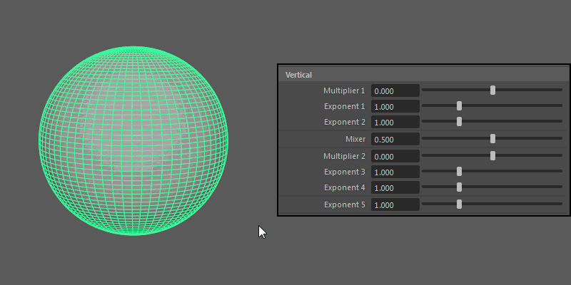

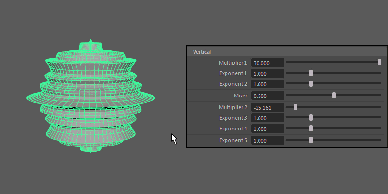

Vertical
Controls the pattern across the ultra shape's longitude.
Controls the main vertical protrusions from the ultra shape. Both values can exist on the ultra shape at once, and you can blend between them using the Mixer attribute.
Controls the extent of the vertical extrusions for Multiplier 1 (Exponent 1 and 2) and Multiplier 2 (Exponent 3 and 4) respectively.
- Exponent 5
- Controls the overall extent of the vertical protrusions resulting from the previous Multipliers and Exponents.
