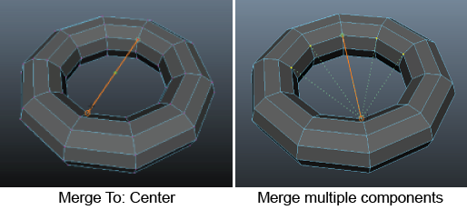

You can toggle between merging components to a target component or at the center of the selected components.
- Select a source component (edge or vertex) or Shift + select multiple components.
- Drag the cursor to a target component (edge or vertex).
Tip: Release your mouse button when your cursor is on the source component to cancel the merge operation.
An orange line appears between the two components. If you selected multiple components then multiple green preview lines are drawn from each source component, showing the result of the merge operation.
If Merge To: Center is on, a green dot is drawn on the orange line to indicate the center point.
- Release your mouse button to merge the components.
