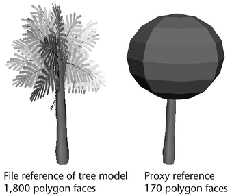

The next example shows you how to add a proxy reference using the Reference Editor, identify it with a unique tag, and then load it into the scene.
A scene contains a file reference to a scene containing a tree model. The referenced tree will be substituted with a simpler proxy reference.

    The proxy file is added to the list of available proxies within the proxy set and the loRes proxy tag is applied. This is indicated by the icon in the Reference Editor. The proxy file will not appear in the scene until you load it.
    Note:
    Whenever you add a proxy reference to an existing file reference, it is not immediately loaded into the scene until you specify that you want it to be loaded.
  7. In the Reference Editor, with the existing file reference still highlighted, select Proxy > Reload Proxy As.
  8. Select loRes from the pop-up menu that appears.
    Maya updates the file reference by loading the treeSimple proxy reference (tagged loRes) into the scene.
