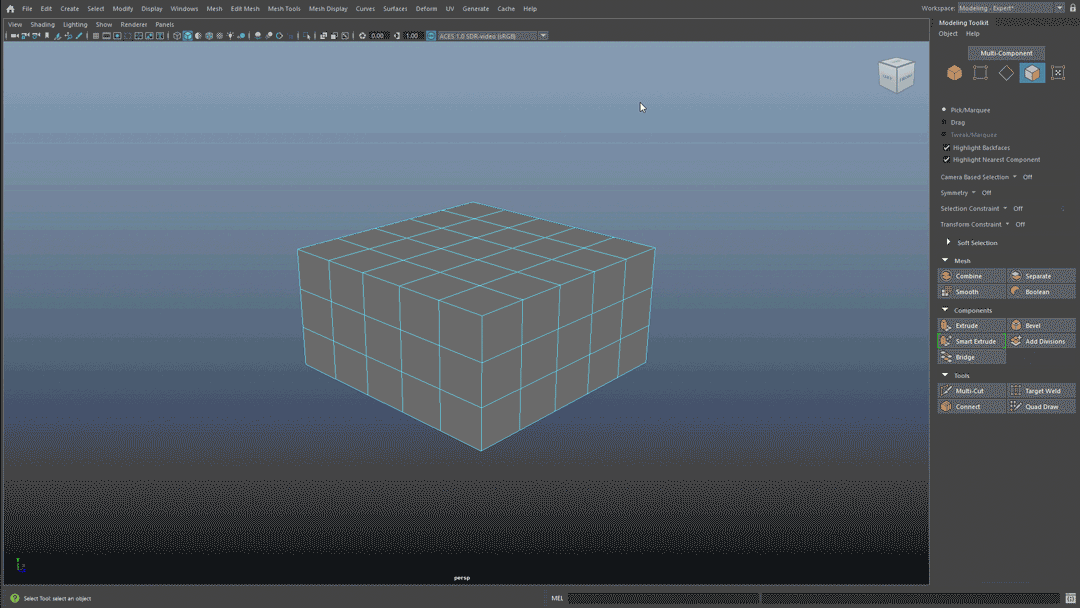

Smart Extrude Updates in Maya
Smart Extrude is a powerful extrude functionality for Maya, which lets you interactively extrude faces in the viewport and eliminates the need to manually repair double faces and unwelded results that occur during a traditional Extrude operation. With Smart Extrude, faces that are fully, partially cut-through or overlapped by the operation results are interactively rebuilt and stitched together, creating new manifold geometry, eliminating the need to manually repair hidden faces or geometric data. Therefore, you can freely explore and modify polygonal mesh topology on your object.
Latest Updates:
  • Smart Extrude now displays an icon above the manipulator in the Viewport when active, making it easier to distinguish from the Move tool manipulator.
  • You can now access Smart Extrude in the poly modeling toolkit.
  • There is now improved Manipulator and Pivot inheritance from the Move, Rotate and Scale tools
  • Performance, reliability and stability of Smart Extrude operations has been improved upon.
To use Smart Extrude fast, you can now do one of the following:
  • In the Poly Modeling Poly Modeling shelf, left-click to activate a Smart Extrude operation when you have a component selection of faces in the Viewport.
  • In the Modeling Toolkit, left-click Smart Extrude to activate the operation when you have a component selection of faces in the Viewport.
  • Note: By default, clicking the button in the Poly Modeling shelf or the Modeling Toolkit performs the smart extrude operation.
