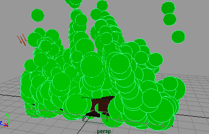

- Play the animation.
Emitted particles appear as circles in the workspace because the particles are displayed as the Cloud render type.
Here’s an example with Shading > Smooth Shade All turned on.
